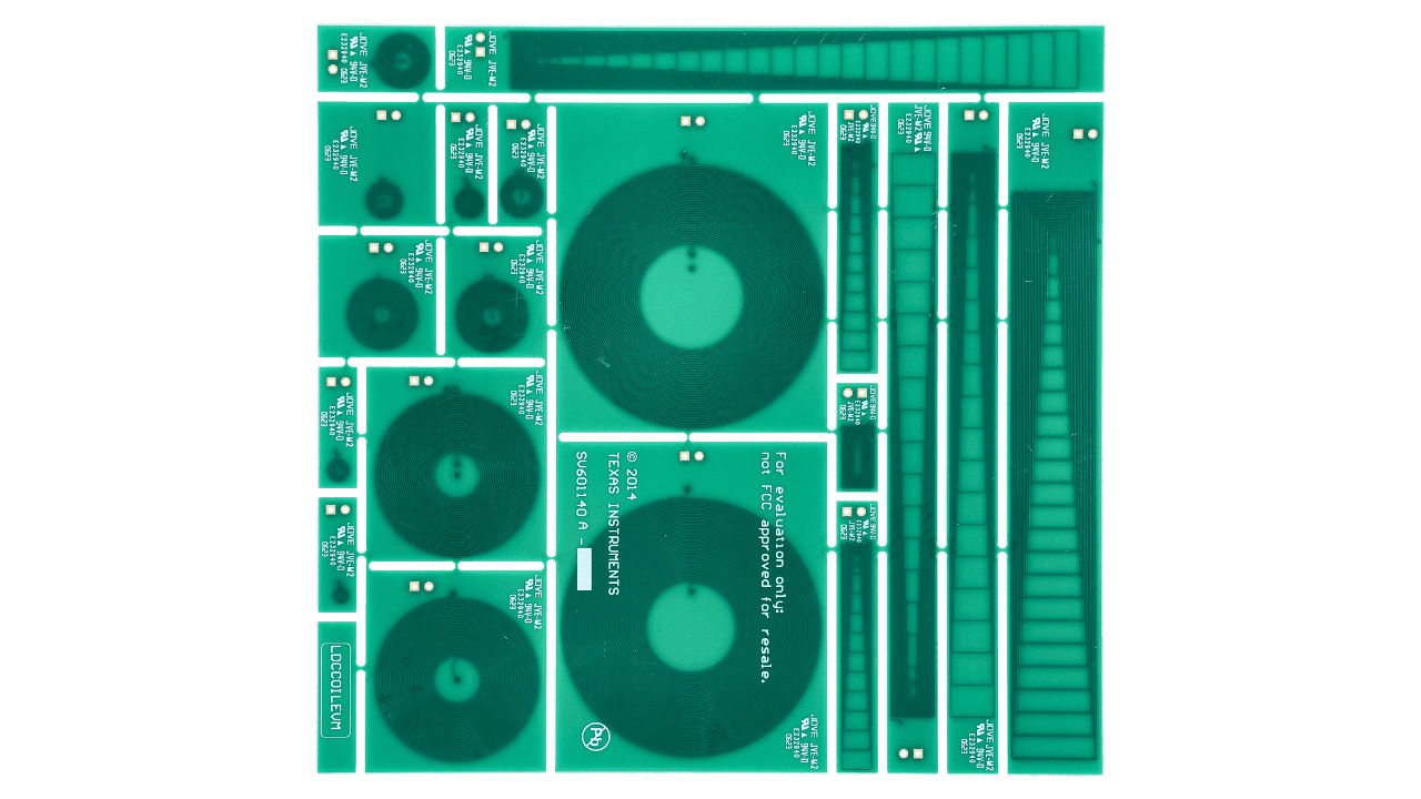

Scanning the bed quickly so bed surfaces can be swapped with impunity is a great use for this technology! However, this is Duet3D so we are looking at other uses for this technology as well. Inspired by the TI reference coil design:
SZPBlog_09.png (image from TI.com “DCCOILEVM Reference Coil Board Evaluation Module top board”)
This shows examples of very directional coils, so we are considering other uses for inductive scanning sensing including:
  • Using a coil or coils to sense a nozzle and determine nozzle XYZ offset. Non contact nozzle position sensing in 3 dimensions will be very helpful for tool changing printers. Current solutions rely on optical image processing, electric contact or physically triggering a switch, all of these can be disturbed by filament residue on the nozzle.
  • Using a higher resolution coil to scan a metal filament print for in process inspection. The original use of this inductive eddy current technology was in non-destructive testing: the ability to look “inside” the surface of metal parts to detect cracks and voids. There may well be the opportunity to use this process to characterise the output when printing metallic parts.
